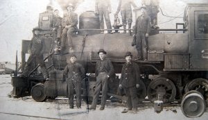

Greetings! We recently acquired several old family albums. This picture of my Great Grandfather and some other men with this locomotive is one of the pictures that was included.
This picture was taken about 1906 or 1907, probably in New York City area. My Great Grandfather was a Machinist. We are guessing that he might have been on the crew that built or maintained this cool old machine.
Any and all help with the ID is appreciated!

Welcome to the forum.
Looks very much like a narrow gauge locomotive. Most standard gauge 2-8-0's would have drivers over 4 feet diameter. Those appear to be about 3 feet as is typical of narrow gauge.
The Denver & Rio grande (Western) had locomotives very similar, and numbered in the 200's.
Here's a couple of typical ones:
http://digital.denverlibrary.org/cdm/ref/collection/p15330coll22/id/46533
http://digital.denverlibrary.org/cdm/ref/collection/p15330coll22/id/46532
Headlights change, cabs could be wood or steel, 1 or 2 air pumps located in different locations, etc.
There is a tender in the left background that has large numbers on the side. That numbering style may be a clue about which RR it was.
